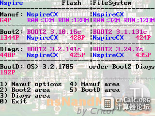

This week-end were released together Ndless 3.6 and nLaunchy 2.4.
Where Ndless 3.6 can be used by absolutely everyone, only needing the latest OS (Operating System) 3.6 from TI, nLaunchy 2.4 still relies on a specific Boot2 version (3.1 for TI-Nspire CX and 1.4 for non-color TI-Nspire), and thus only targets owners of TI-Nspire CX hardware revision 'A' to 'I' and older TI-Nspire calculators.
Unlike Ndless 3.1, Ndless 3.6 doesn't install itself automatically after a reboot. But fortunately, Excale told you in his nLaunchy 2.4 news that this new tool was able to automatically install Ndless after a reboot. {:biggrin:}
Happy owners of TI-Nspire CX hardware revision I and all previous TI-Nspire calculators, you'll be able to use Ndless 3.6 exactly like Ndless 3.1 ! {:thumbsup:}
You were now just missing a tutorial that you're going to find below.
No problem if you don't have the nLaunchy compatible Boot2 on your calculator, the tutorial will take care of this thanks to the latest nsNandMgr 2.0, the NAND flashing tool updated for Ndless 3.6. {:happy:}
Making Ndless 3.6 reboot-proof tutorial : http://tiplanet.org/forum/viewtopic.php?t=14090
