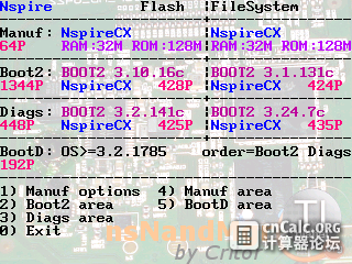

Ok we don't have nLaunchy. But we have the new nsNandMgr v2.0 for Ndless 3.6, the utility to reprogram the NAND memory which lets you for example reset the minimum installable OS version to 0.0.0.0.
And indeed, it works! Once this minimum version is reset, we can actually install the old OS following :

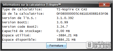

We could have stopped with this, but we still attempted an installation of OS 3.1 and oh... how strange... it works half. :o
Unlike OS 3.2.0 it does not put the calculator in a restart loop and starts, but it's obviously unable to display any icon or string correctly, saying it cannot find its resources.
And this is where we begin to understand what TI has done... ;)
If OS 3.1 doesn't find its resource files containing icons and strings, it's that it just cannot access the filesystem content included in NAND memory.
TI has probably blocked read access to the NAND for 3.2.0 and earlier versions on HW-J+, by changing a hardware port for example.
And some of you will are going to object to me that if the OS has still managed to launch its code which is stored in the same memory, it's that it could be read...
True - except that it is the Boot2 that handles loading the OS code from the NAND storage memory to the SDRAM. And as it is Boot2 version 3.2.4≥3.2.3, it knows the new HW-J+ NAND memory access method.
Finally, we notice that the write access to the NAND memory was probably blocked also on HW-J+ for versions 3.2.0 and earlier, as the calculator in the previous state reports us nonsense about the filesystem, with null or even negative sizes, implying among other things that any attempt to write anything is going to fail.
