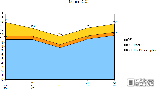

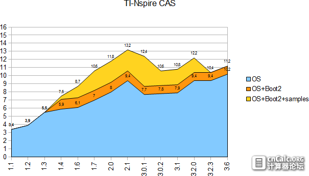

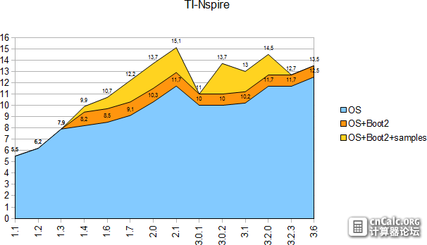

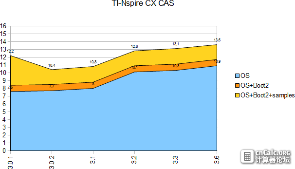

In a previous news, on the occasion of the release of the OS (Operating System) 3.6 for TI-Nspire, we were exposing a small history of TI-Nspire OS sizes and of the space which could be gained for each one by using the TNOC utility.
Indeed, the OS installation file size has been increasing year after year, and now stands from 9.6 to 11.8 MB depending on the TI-Nspire model targetted by the 3.6 version.
However, be aware that the installation file of the OS is recorded and stored as such on the calculator in the hidden path "/phoenix/install/TI-Nspire.tnc".
Our TNOC utility principle was thus to lighten the OS installation file a little by removing some unnecessary entries, including:
  • the image of the Boot2 (used only for an update that might be performed only once in the life of the calculator)
  • sample files (will not be helpful to some new users )
This was enough to save several megabytes :

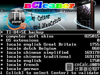

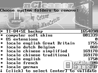

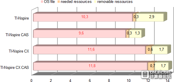

Thanks to the release of Ndless 3.6 last weekend, it is now possible to use the nCleaner utility on OS 3.6.
nCleaner looks for unnecessary resources in the file system, and tells you in each case how much free space their removal is going to bring.
Among these resources are:
  • a 1.5 MB image of the archive memory of a TI-84+SE on monochrome TI-Nspire non-CAS, useless if you do not use the TI-84 keyboard removable
  • big vectorial skins the calculator, having nothing to do here since no screen or menu displays them
  • data for the 14 to 15 languages of the​​calculator
Among these resources you can remove all of them without danger, and except for the TI-84 + SE archive on monochrome TI-Nspire non-CAS calculators without any loss of functionality ! {:thumbsup:}
Yes indeed, remove language resource files doesn't prevent from using the matching language at all, as the OS can directly load those ressources from the "/phoenix/install/TI-Nspire.tnc" file.{:biggrin:}

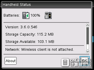

With nCleaner Ndless 3.6 and then you can earn up to 1.3 to 2.9 MB of free space on your TI-Nspire running OS 3.6.
So your calculator can reach free space capacities that you dared not even dream of with this latest OS . :D
Even if the gain can be considered negligible on the TI-Nspire CX with their 115.2 MB storage capacity, on the TI-Nspire monochrome with their 27.8 MB to which you have to substract the OS installation file size is quite useful for some additional PDF documents ;)
