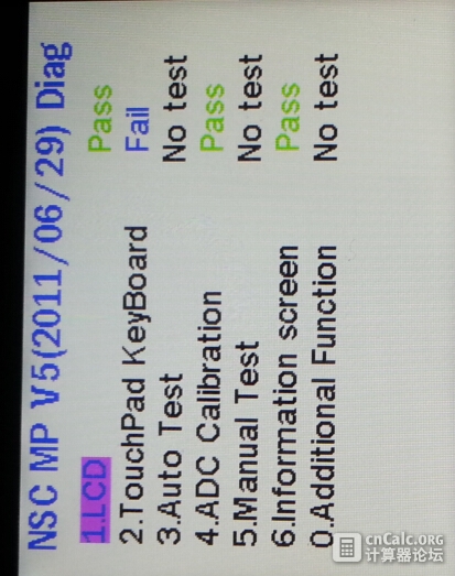

[Nspire] Nspire卡在diag无法启动?谁能维修!
发表于 2014-11-11 21:24:22 | 显示全部楼层 |阅读模式
联络方式:78602777
开机状态
开机状态

发表于 2014-11-12 04:27:48 | 显示全部楼层
It's a side effect which happens randomly as far as we can understand for now.
Go into "0.Additional Function" and then validate "Go to OS mode".
Then press 'reset' on the back of the calculator - it should reboot into the OS.
 楼主| 发表于 2014-11-12 09:29:49 | 显示全部楼层
自己昨晚瞎摸索竟然修复了,而且系统从3.9成功降级到3.6,哈哈,很好!
