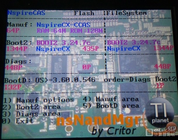

前几天计算器进不了自检了,用瑞士军刀一看,发现diags的镜像不见了
我的事CX CAS,那个CX C是用瑞士军刀改的
我的是CX CAS,谁有镜像提取一下,谢谢了

Do you need to reflash a TI-Nspire CX Diags image ?
Most of them are available on TI-Planet :
http://tiplanet.org/forum/archiv ... re+CX+Diags&id=
Just put the downloaded file as "diags.img" in the "ndless" folder of the calculator and launch nsNandMgr.
It should detect the file and let you flash it.
 楼主| 发表于 2014-11-23 23:19:03 来自手机 | 显示全部楼层
