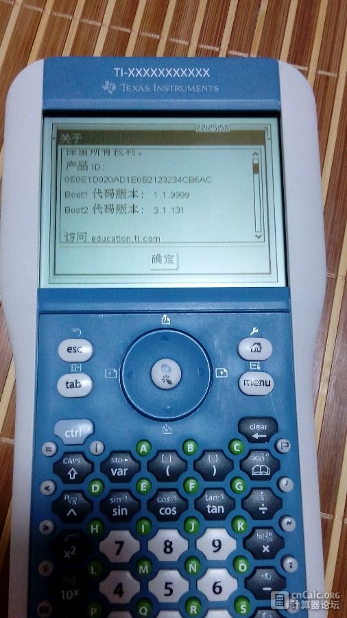

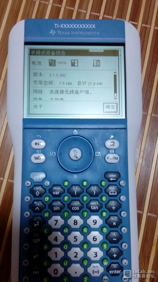

Sorry I understand error,Thanks to you ,I  was successful!!!!!!
To my surprise,the Prototype OS2.0 does not have Anti downgrade measures,So I esaily back to Prototype OS1.9.
I have a question,can the TI-XXXXXXXXXXX Install CAS?

发表于 2015-5-24 01:47:29 | 显示全部楼层
Great !
There are several ways to install a CAS OS on your prototype :
- install the Nlaunchy OS launcher which doesn't check the calculator CAS/non-CAS type before launching the OS
- mod your Flash model ID from TI-Nspire to TI-Nspire CAS using nsNandMgr
In both cases, you can only install OS versions up to 3.3. Versions 3.6 and newer are going to freeze on startup on this prototype.
