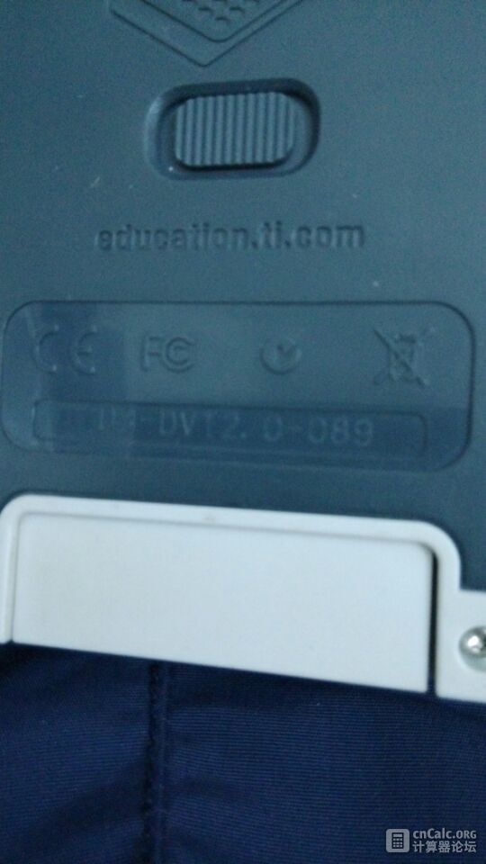

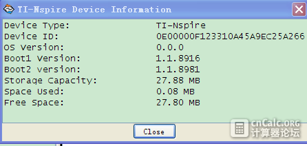

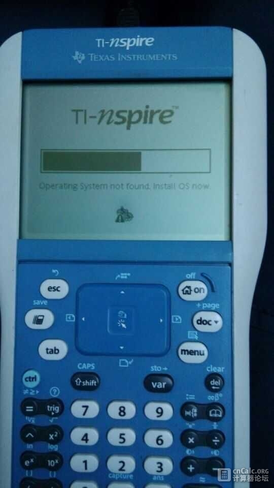

Recently,I buy a ti nspire no cas,and i discover it is a dvt,it can't gei into the OS,so i delete the os,and i can't gei the 1.19227os into the nspire,now,what should i to do?@critor

An engineering machine exactly= =.I have never seen such an edition...Big Blue?

it can use os 1.7 but can,t  use   os2.0

According to the display, your calculator doesn't seem to behave as a prototype.
Try to send the released OS ?
- first, any OS between 1.4 and 2.0.1 to update the Boot2 to version 1.4
- then any newer OS

it can install os 1.7,os 2.01.  can,t install os1.6,os1.4,os3.1,but can,t use os 2.01,and it boot2 always is 1.1.8981
