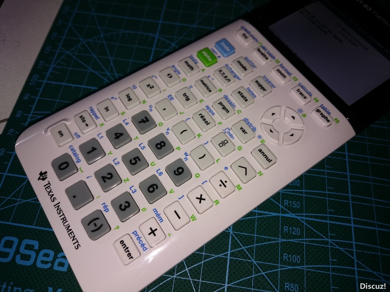

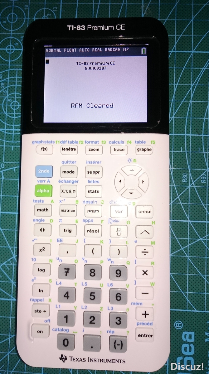

发表于 2017-6-7 13:38:29 | 显示全部楼层 |阅读模式

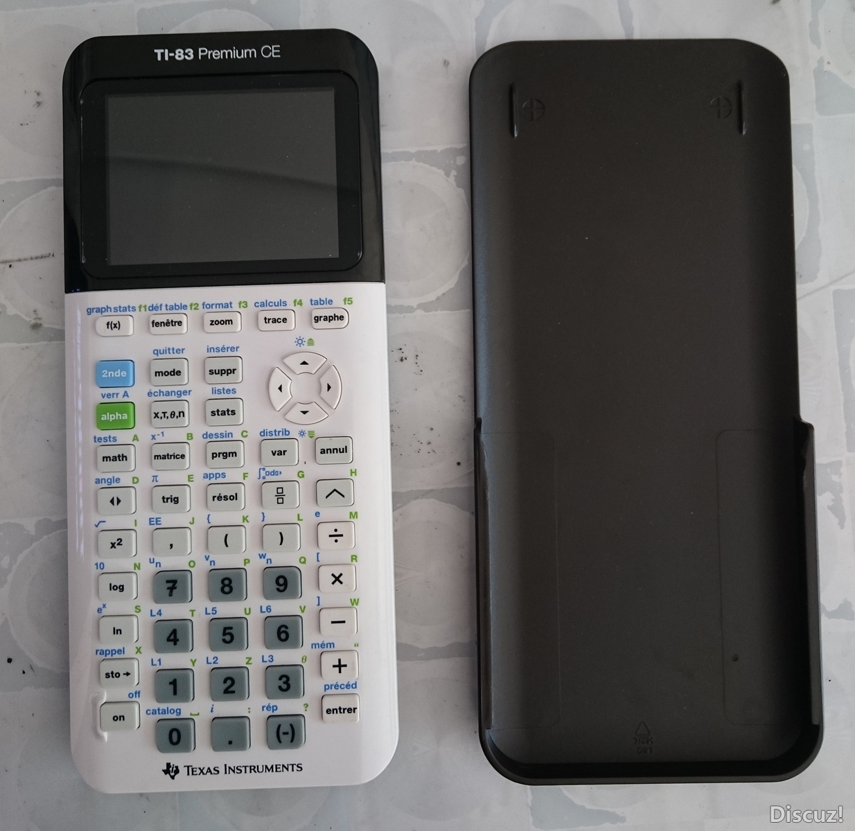

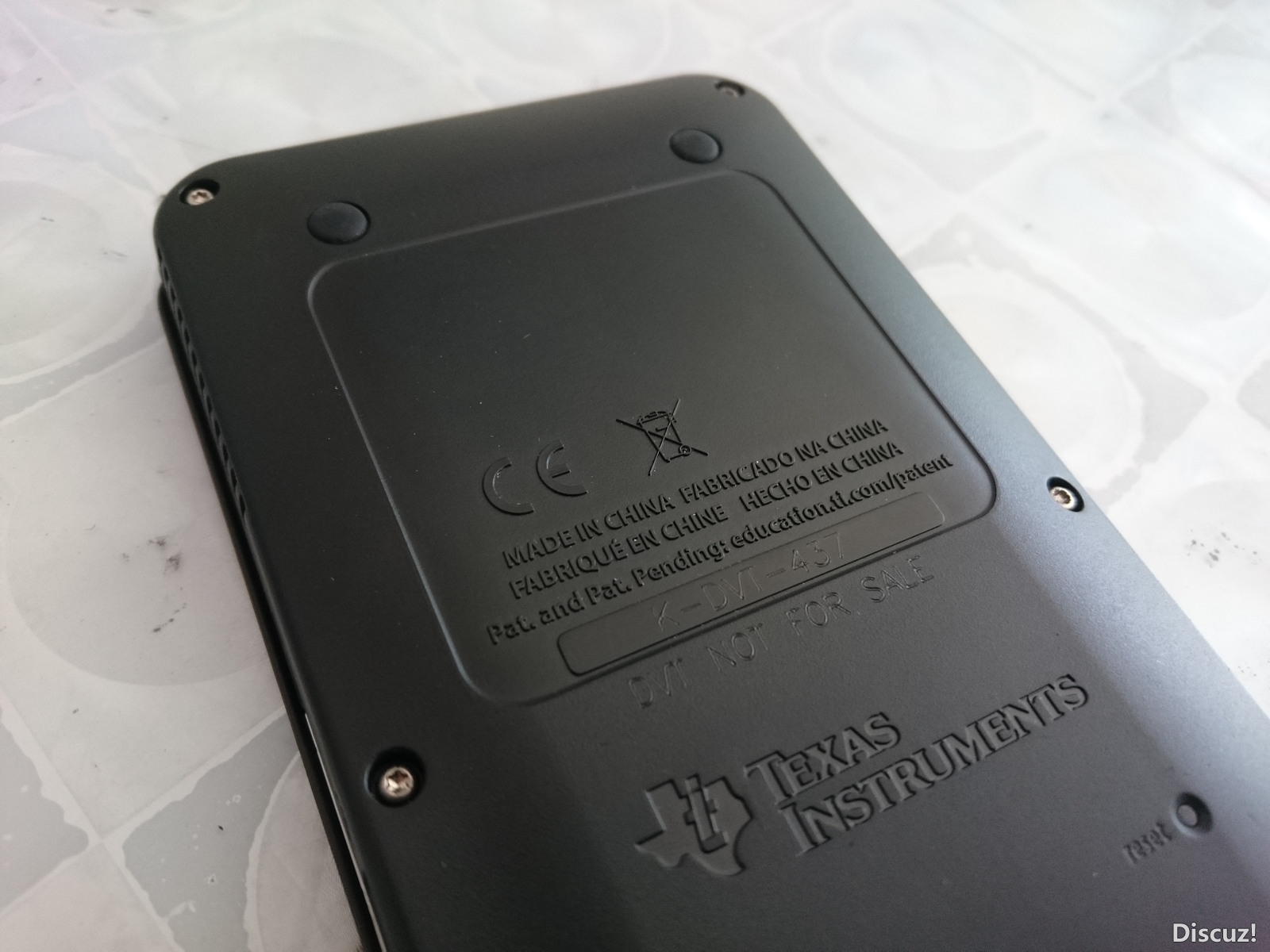

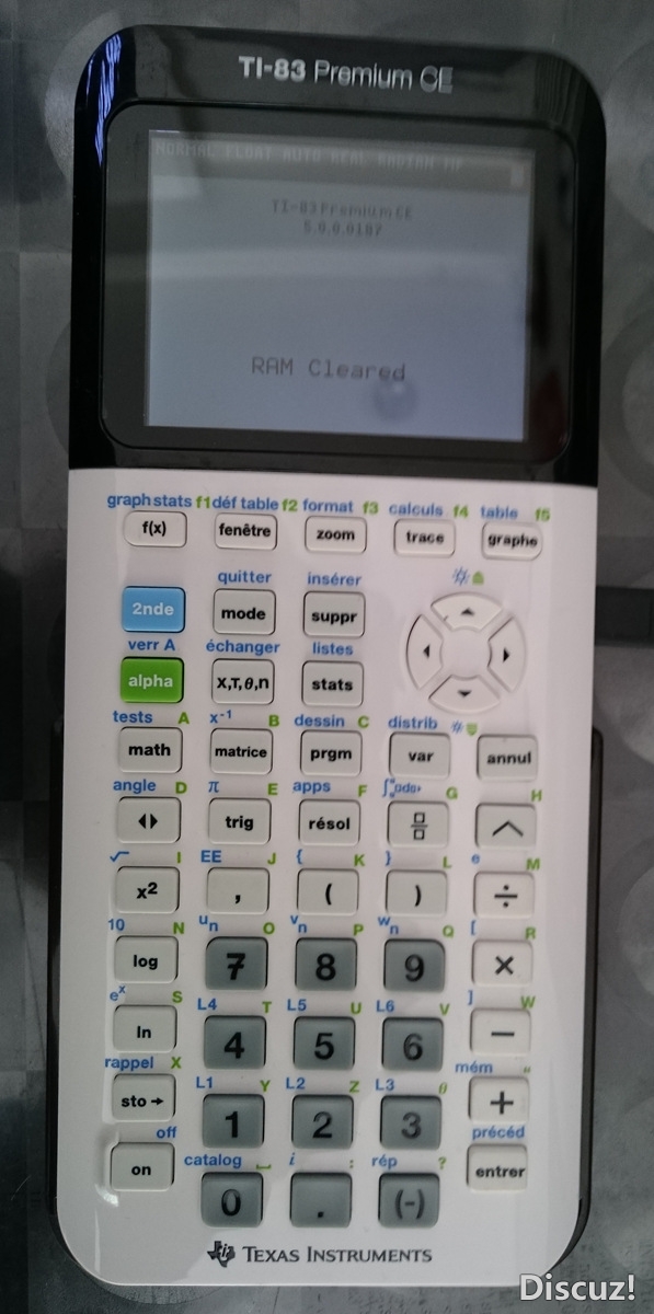

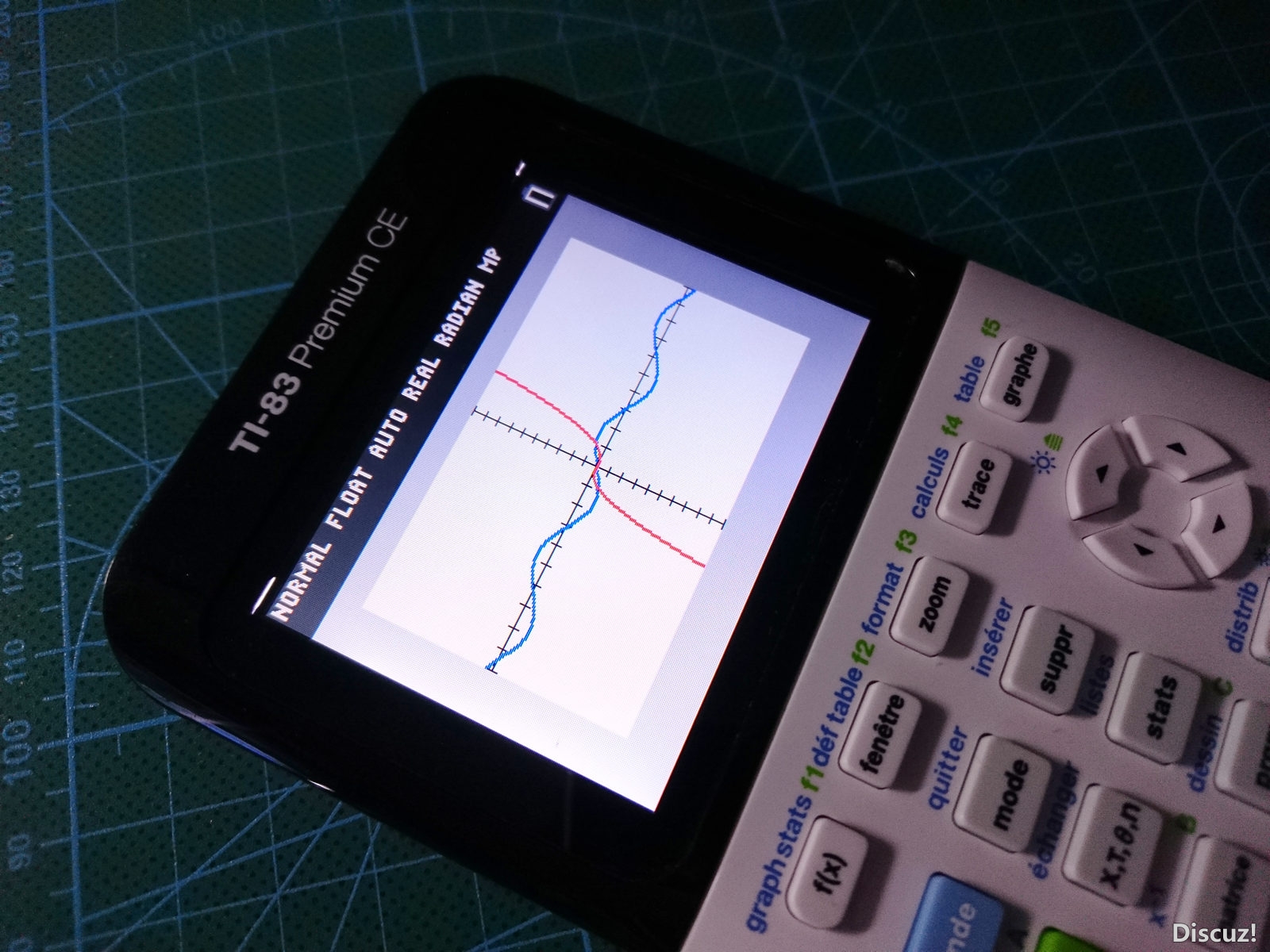

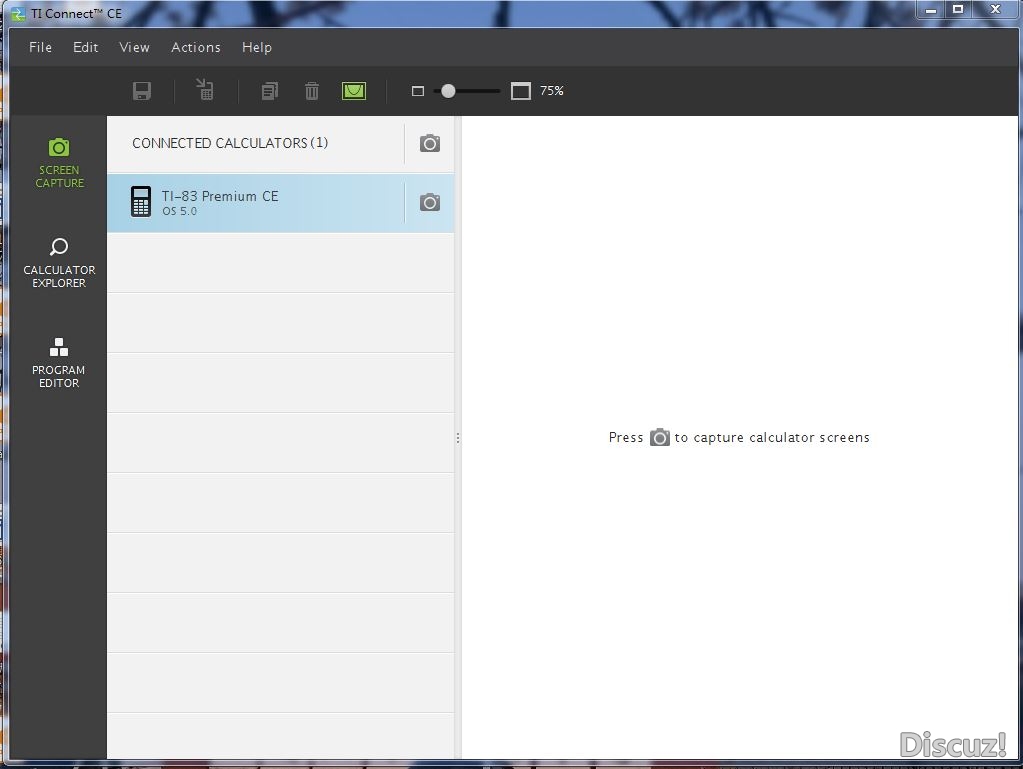

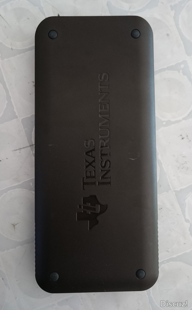

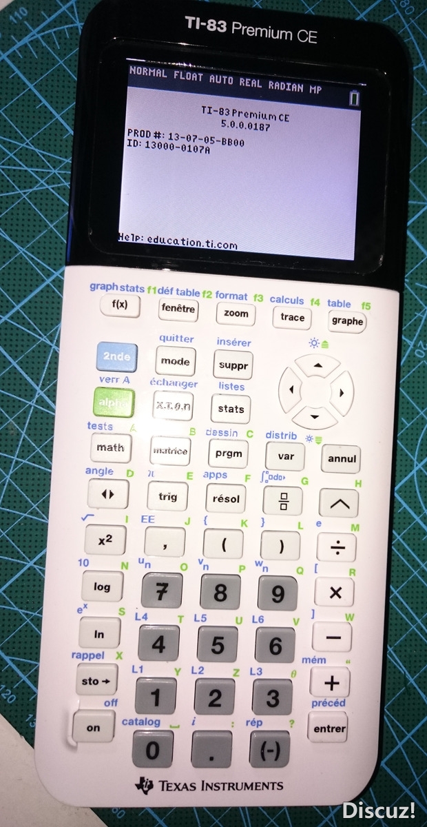

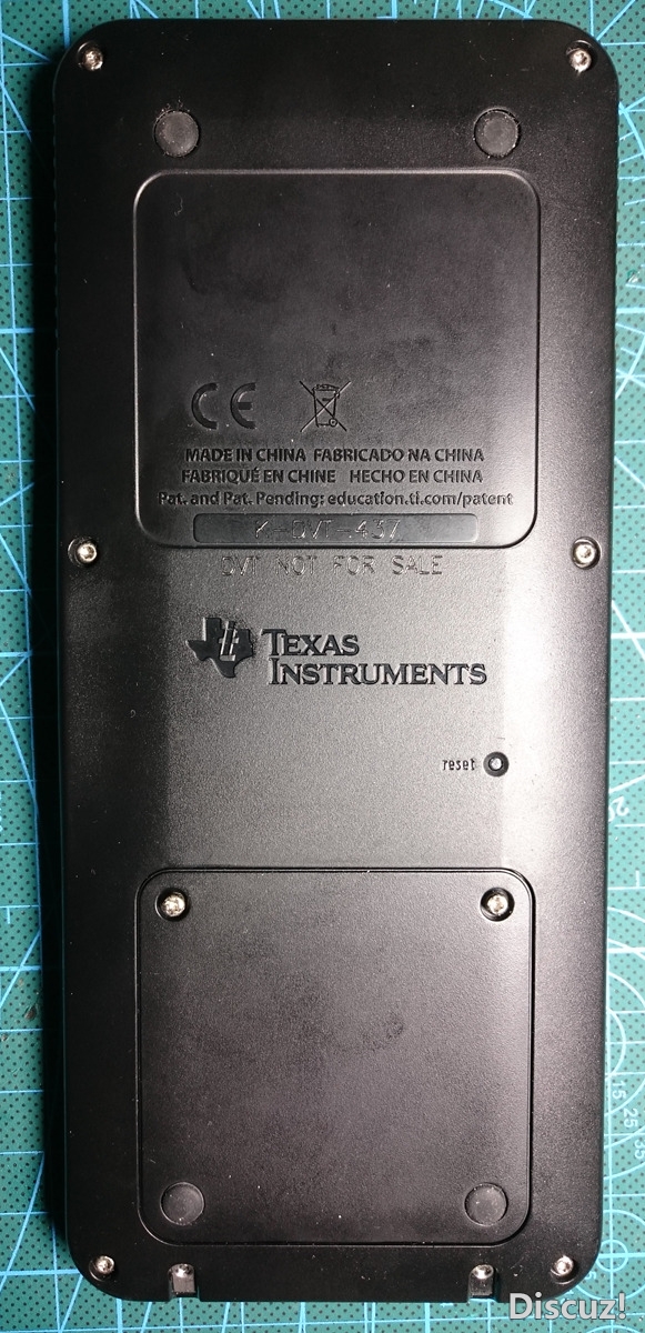

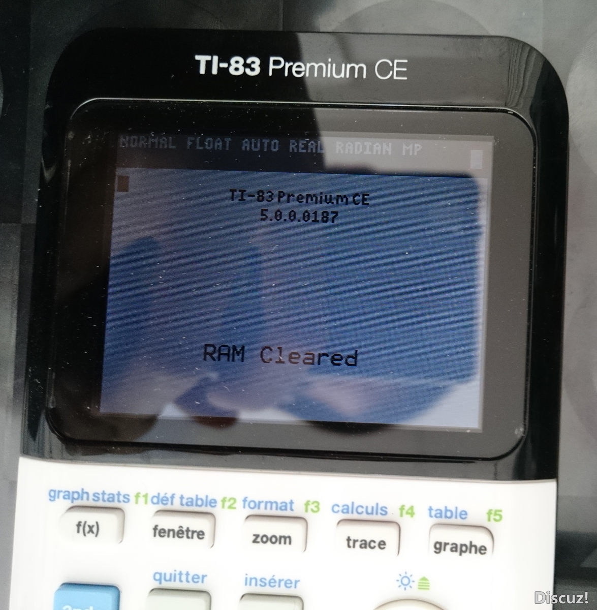

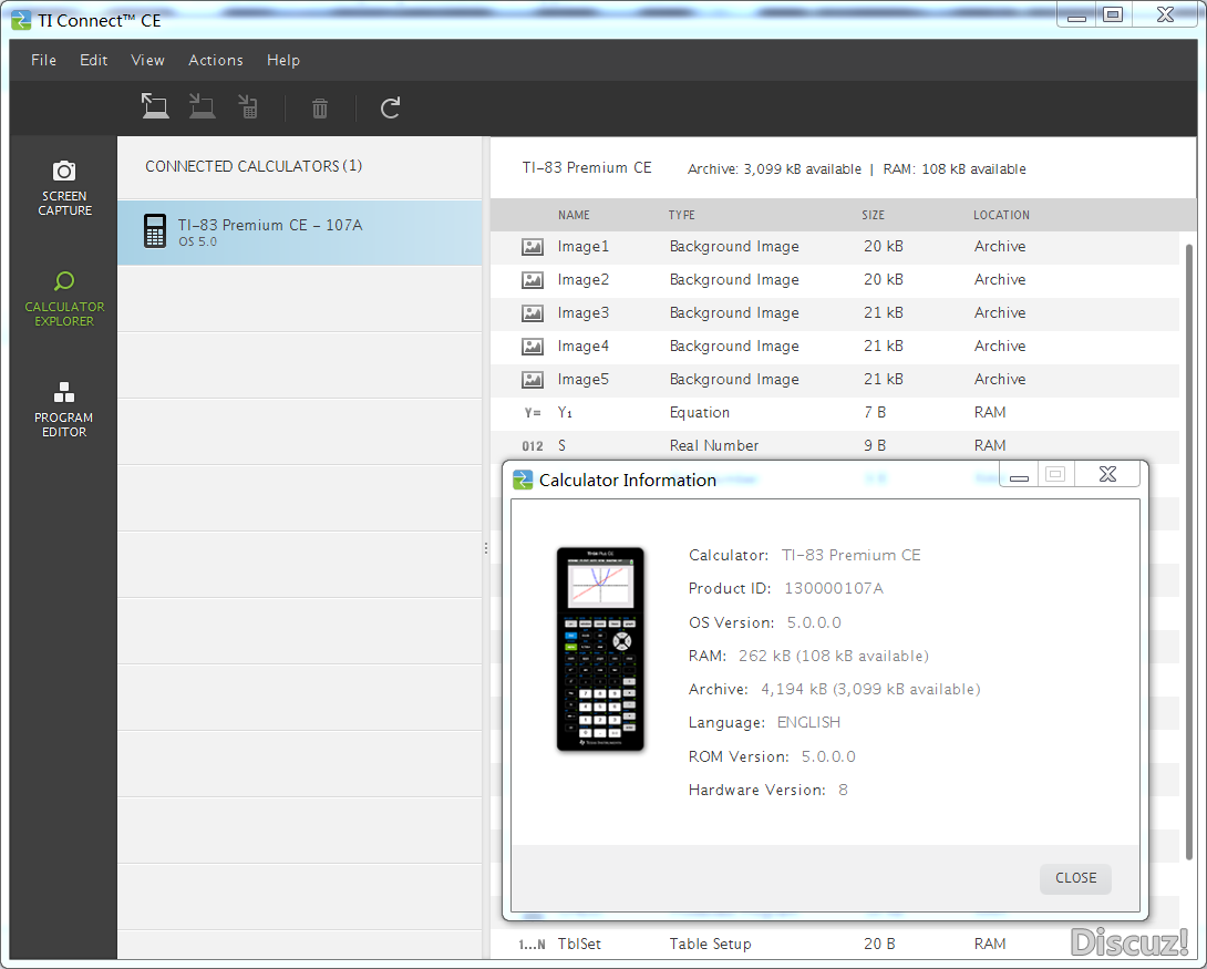

如题。在某网站收了一台  TI-83 Premium CE 图形计算器,结果收到后发现是工程样机(背后有“DVT”字样),OS版本 5.0.0.0187,经测试连接到电脑端 TI Connect CE 也无法给这台计算器升级系统。所以来论坛咨询一下大家,工程样机有没有研究价值,硬件会不会有什么 Bug,不能升级系统会不会影响以后的使用。如果不适合日常使用的话,打算就去退货了。
下面上传一些我收的这台 TI-83 Premium CE 工程样机的照片。

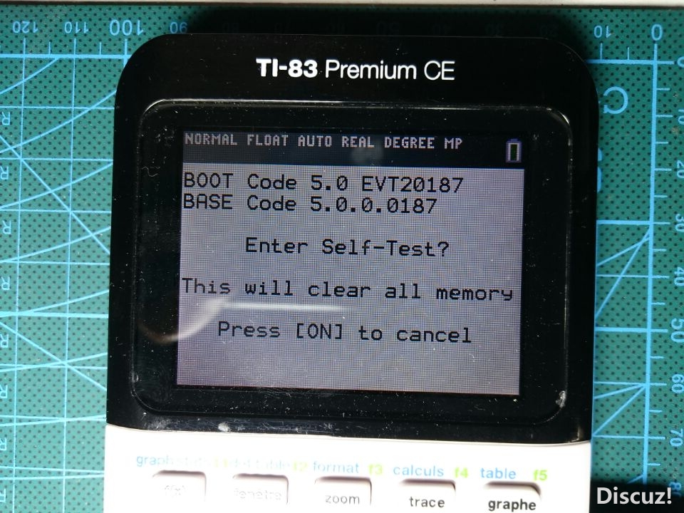

You could check the Boot Code version, since it's dealing with the update -> MODE ALPHA S
Also, could you start by dumping this strange OS ?

 楼主| 发表于 2017-6-8 01:42:12 | 显示全部楼层
critor 发表于 2017-6-7 15:12
Hi.
Very interesting.

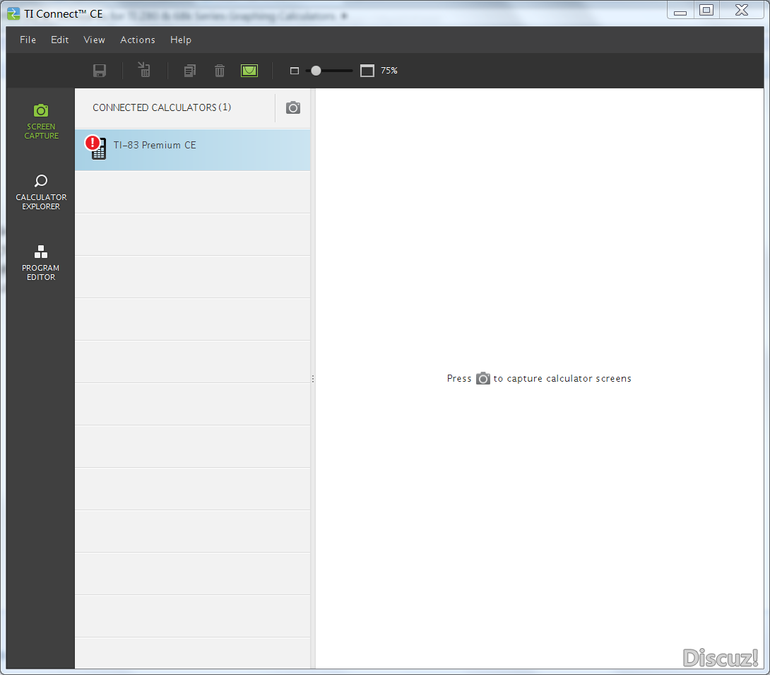

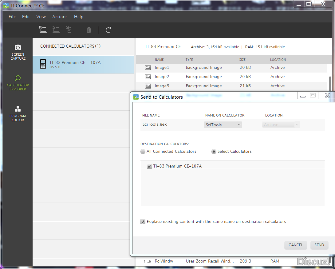

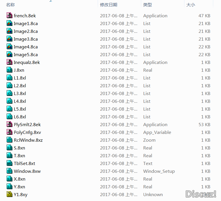

Boot Code: QQ图片20170608011513.jpg

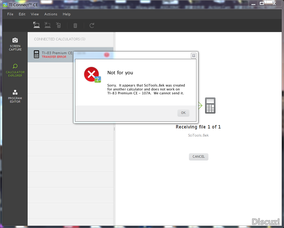

I tried send some TI-84 Plus CE Apps to the TI-83 Premium CE Calculator, but it does not seem compatible with ".8ek" files.

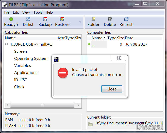

And I tried to dump the OS, but I failed. I think maybe I have any mistakes in the operation. Please tell me if I have any mistakes.

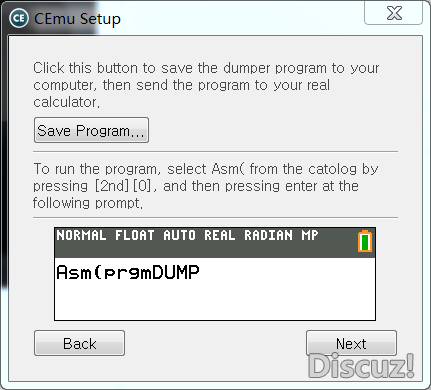

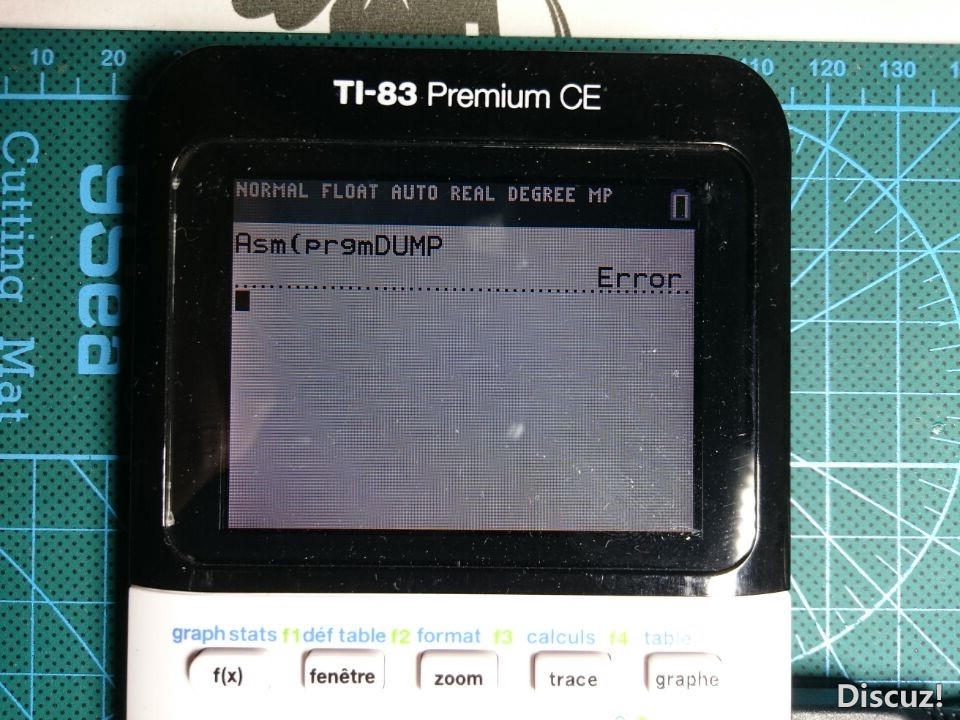

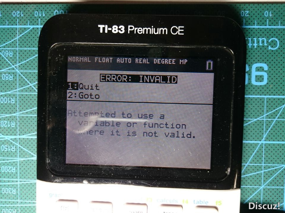

CEmu:
I save the program as "ROMDumper.8xp" and send it to the calculator, then run it from the homescreen by pressing [2nd][0], and selecting the "Asm(" token, then select "DUMP" from the program menu. Unfortunately I get an error message on the calculator's display.
TiLP II 1.18:
I just don't know how to use this program. So I can't dump the OS with it.  Maybe I got a incompatible version of GTK+ but TiLP need a correct one?
发表于 2017-6-8 03:52:07 | 显示全部楼层
Thank you very much for your attempt.
We're trying to investigate this, and then we'll get back to you, for both the dumping and the upgrade.

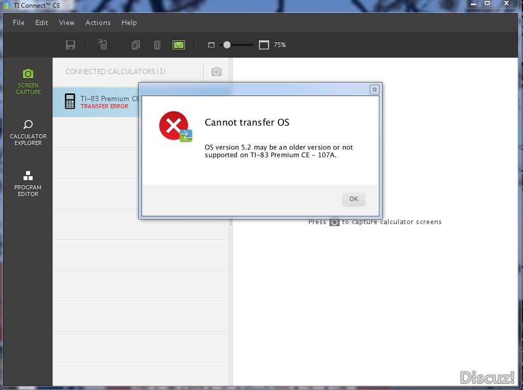

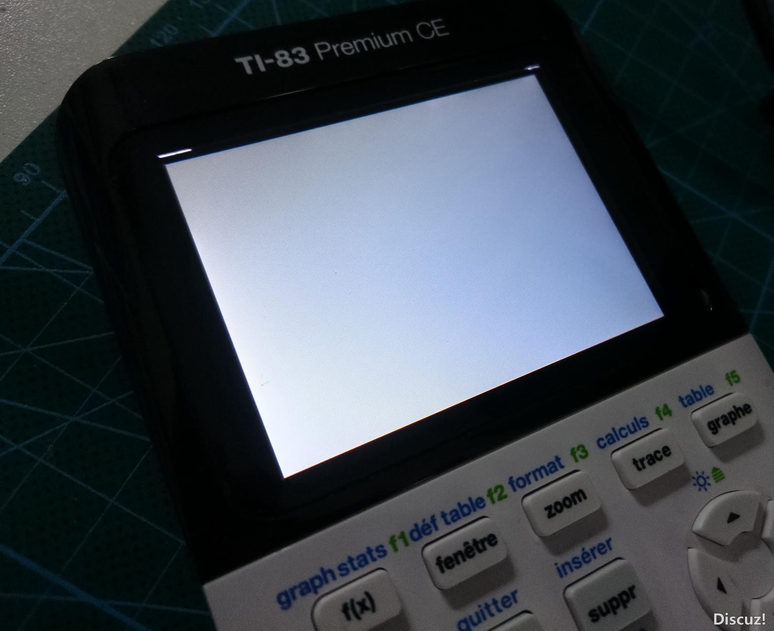

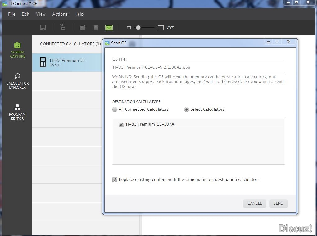

Bad news: I tried upgrading to the TI-84 Plus CE OS 5.2 (use the OS file "TI-84_Plus_CE_5.2.2.0043.8eu") with TI Connect CE, and then the TI-83 Premium CE calculator turned into a brick. Is there any way to get it back to normal? Please help. Thank you very much.
发表于 2017-6-8 17:27:37 | 显示全部楼层
Not really bricked.
But that's why I warned you about the 2 DVT prototypes generations incompatibilities, and why it would have been wise to complete the dumping first.

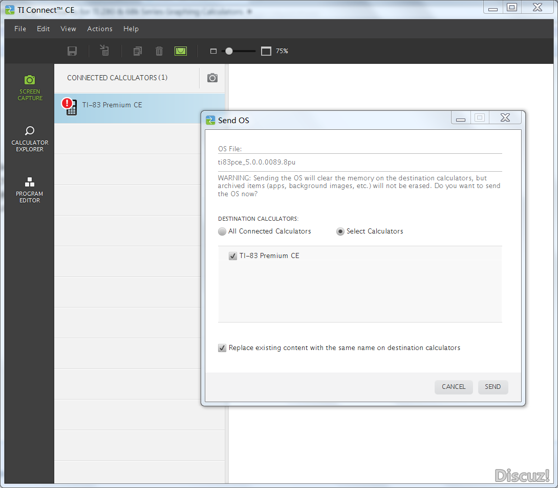

I've read your posts and seen your warning, but I thought that TI Connect CE would prevent the OS update of different models, then I found I was wrong. The TI-83 Premium CE calculator just received the TI-84 Plus CE OS file which TI Connect CE sent to it, and perform the update, then it stuck on a white screen whatever I do.
I tried your suggest by performing a reset while holding 2 keys : [2nde] [suppr], but nothing happened with it. The calculator still stuck on a white screen. TI Connect CE cannot find the calculator, so I cannot send a compatible OS which your tell me to download. Is there anything wrong with my operation?
Thanks.

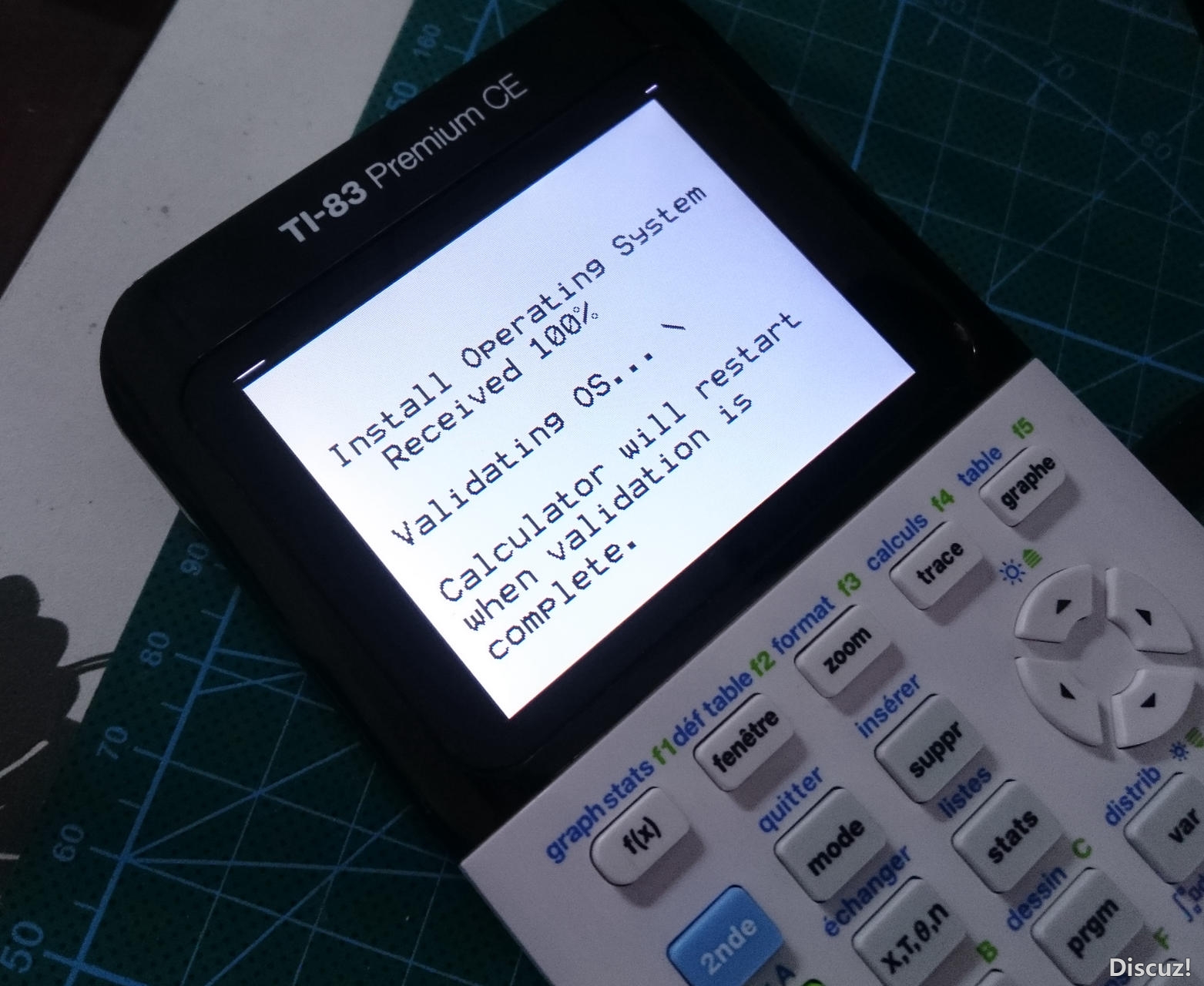

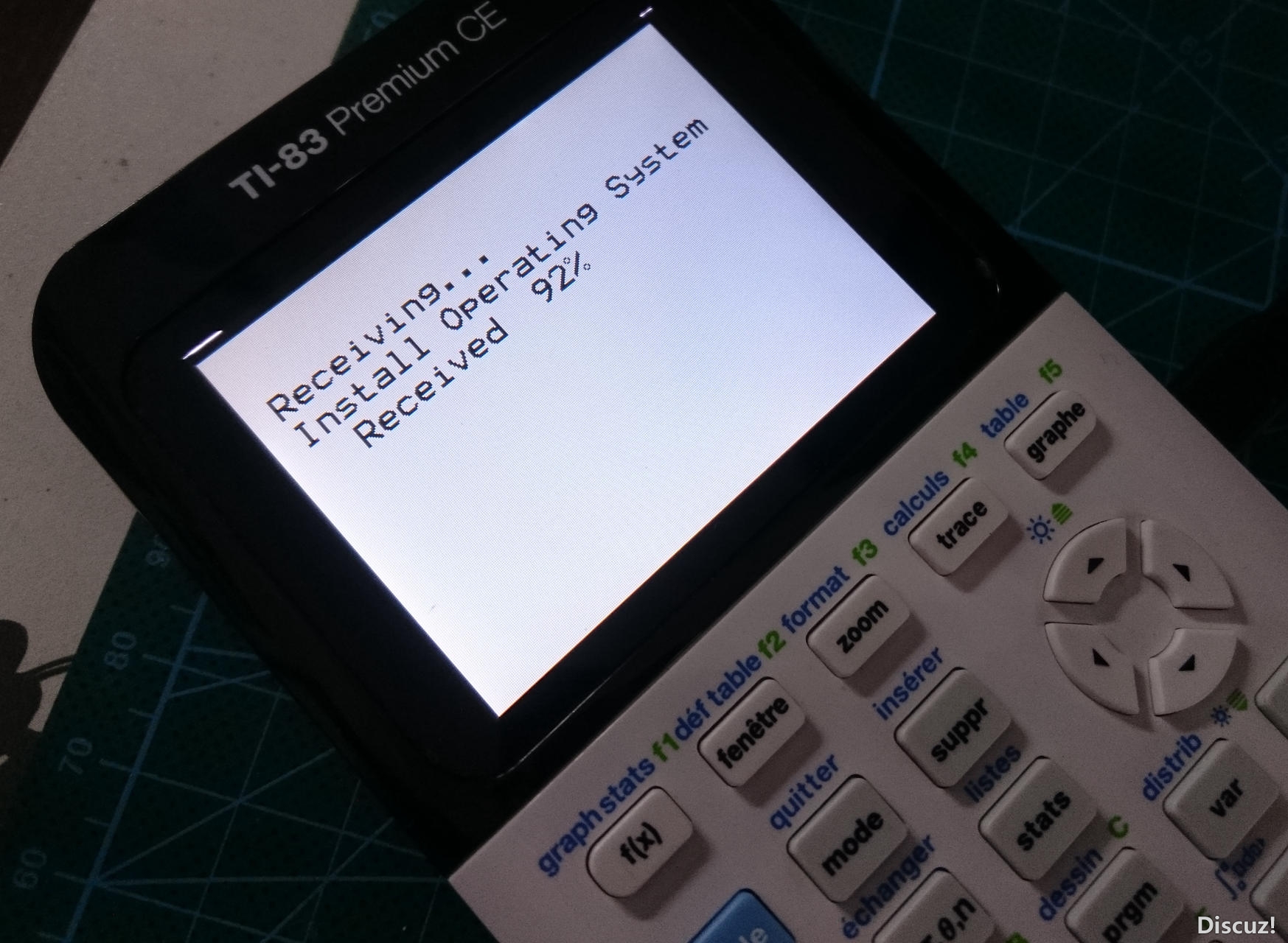

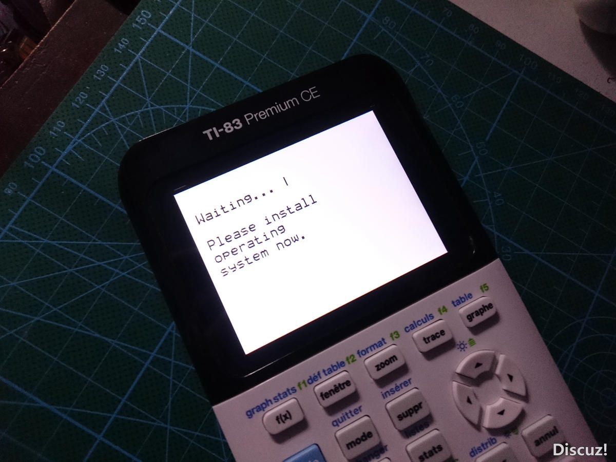

I tried the two methods, then I found that the second method (reset and press & hold the [suppr] key) is work.

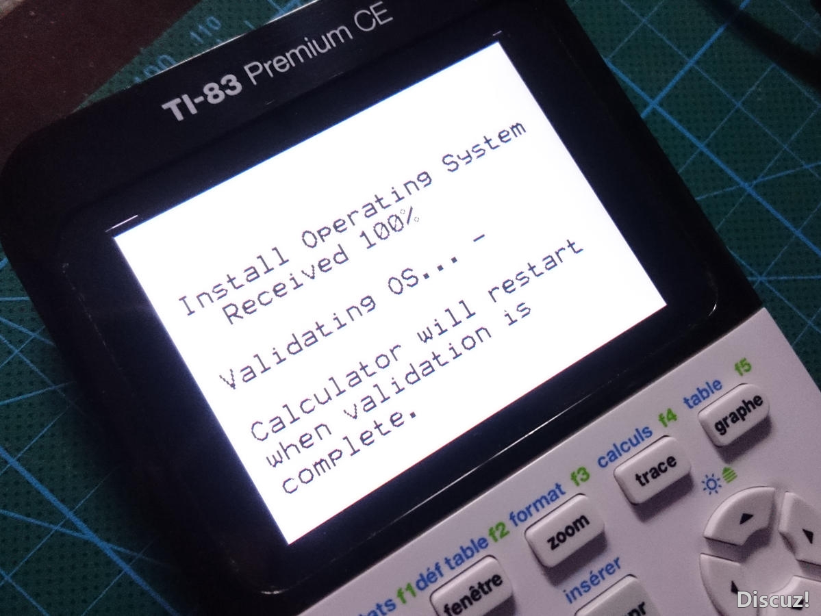

Then I use TI Connect CE to send the OS file "ti83pce_5.0.0.0089.8pu" to the calculator, then it works. But when the OS installing is complete, the calculator is still stuck on a white screen whatever I do. I reset the calculator again, but it is still not come back to normal.
Can I try it for another OS file if there is one compatible?
发表于 2017-6-8 20:40:23 | 显示全部楼层
Ok, great - it's getting better. :)
Apparently, the [suppr] boot combo was changed to [2nde]+[suppr] later.
I'm sending you a private message.

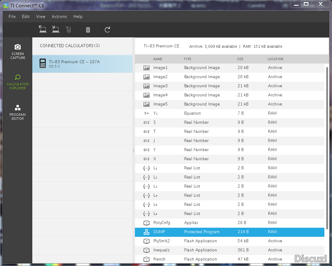

I am very sorry to make we lose a rare opportunity to dump the strange OS 5.0.0.0187. It's all my fault to make this rare TI-83PCE DVT-EVT2 2013 prototype into a brick. Now it cannot power on anymore, just display black screen.  If I had been waiting for compatible dumping tools and didn't try to update the OS before dumping the OS file, it wouldn't have been this result.
In this case, at first I tried send the “TI-83_Premium_CE_5.2.1.0042.8pu” OS file, and "TI-83_Premium_CE_5.1.1.0112.8pu" OS file to the TI-83PCE DVT-EVT2 2013 prototype, through TI Connect CE software. All of them are incompatible. TI Connect CE software prevented the incompatible upgrade. Then I tried send the “TI-84_Plus_CE_5.2.2.0043.8eu” OS file through TI Connect CE software, but this time TI Connect CE software didn't prevent the OS upgrade, then I make the calculator into a half-brick stuck on a white screen whatever I do. All the OS file I used are come from TI's offical website.
Then I tried to unbrick the calculator. But I cannot find a compatible OS for this calculator. I should have dumped the OS file before, but I didn't. In the end, I executed a dangerous operation, which make it completely into a brick and cannot power on anymore. Now it cannot be recognized by Windows PC and TI Connect CE anymore, it just shown as an Unknown Device in Device Manager.
I just do not understand that: why TI Connect CE software block the upgrade of the OS file of TI-83PCE production models, but without preventing upgrade of the OS file of different TI-84 Plus CE production models.
In any case, I have made a lot of attempts and learned a lot. Fortunately, before the calculator turns brick, I have taken some photos of its screen display informations. And I got all the apps & archived vars from this TI-83PCE prototype via TI Connect CE software. I found that the ".8ek" file which get from this prototype is compatible to it, and TI Connect CE can send it back to the calculator. But the ".8ek" file which from TI's offical website and other forums is incompatible to it, and TI Connect CE cannot send it to the calculator. If these files are useful, anyone can get them from me (use private message please).

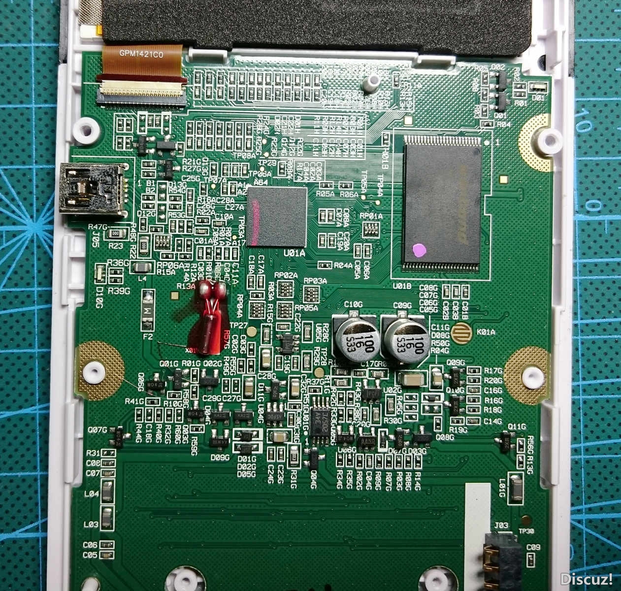

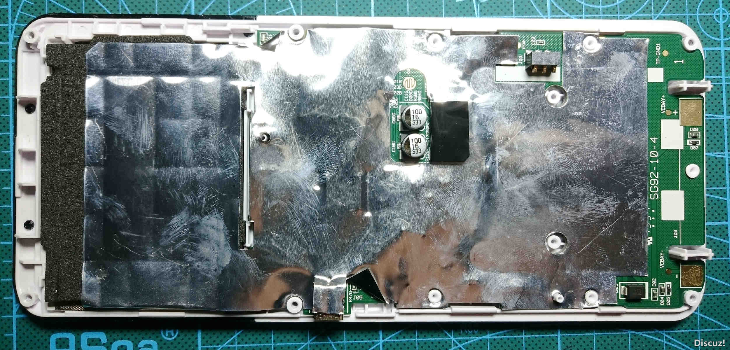

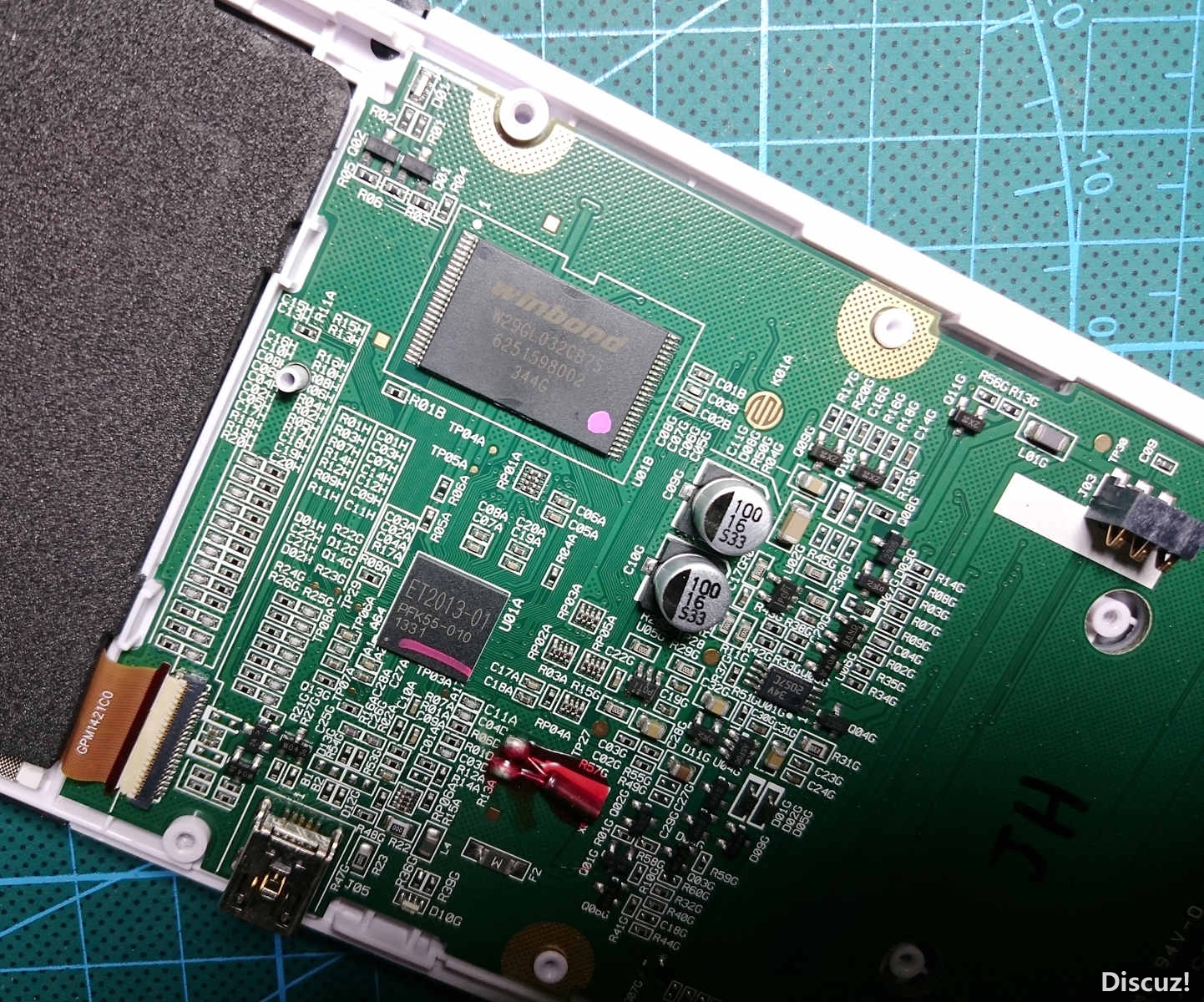

Soon after, I will upload some photos about the disassemble of this TI-83PCE prototype, you can see the PCB and main chips on it.
That's all I can share here. Hope to be useful to others.

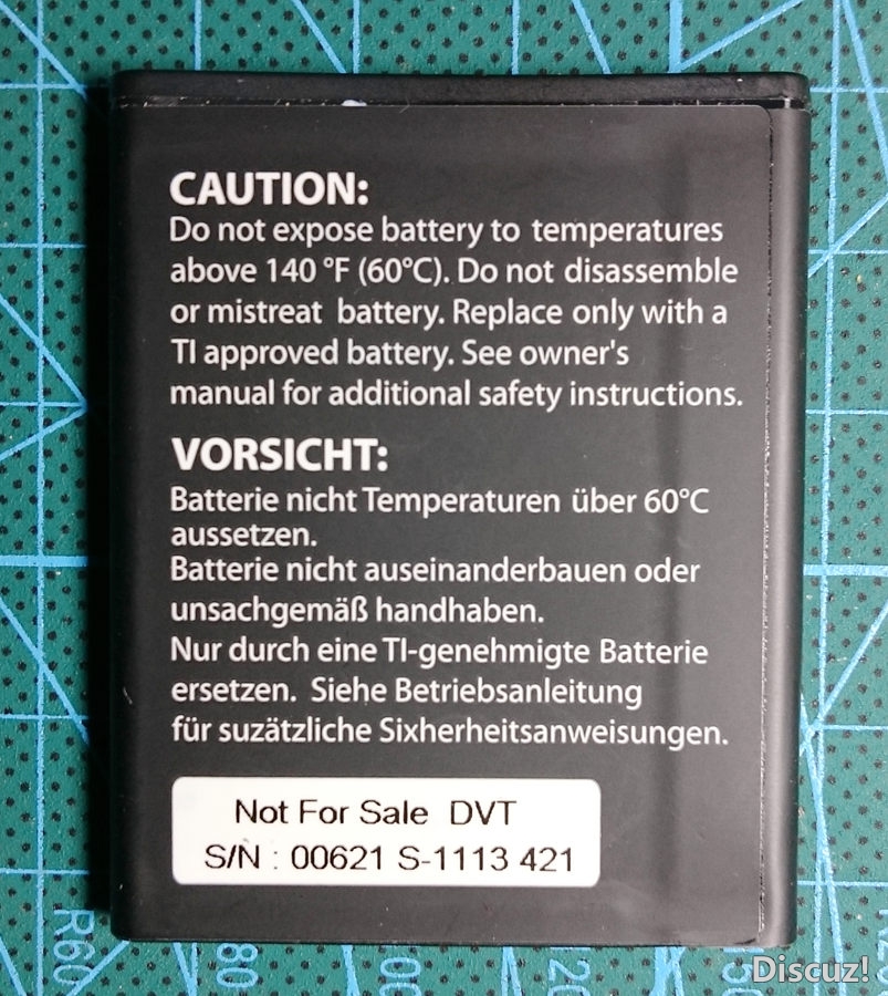

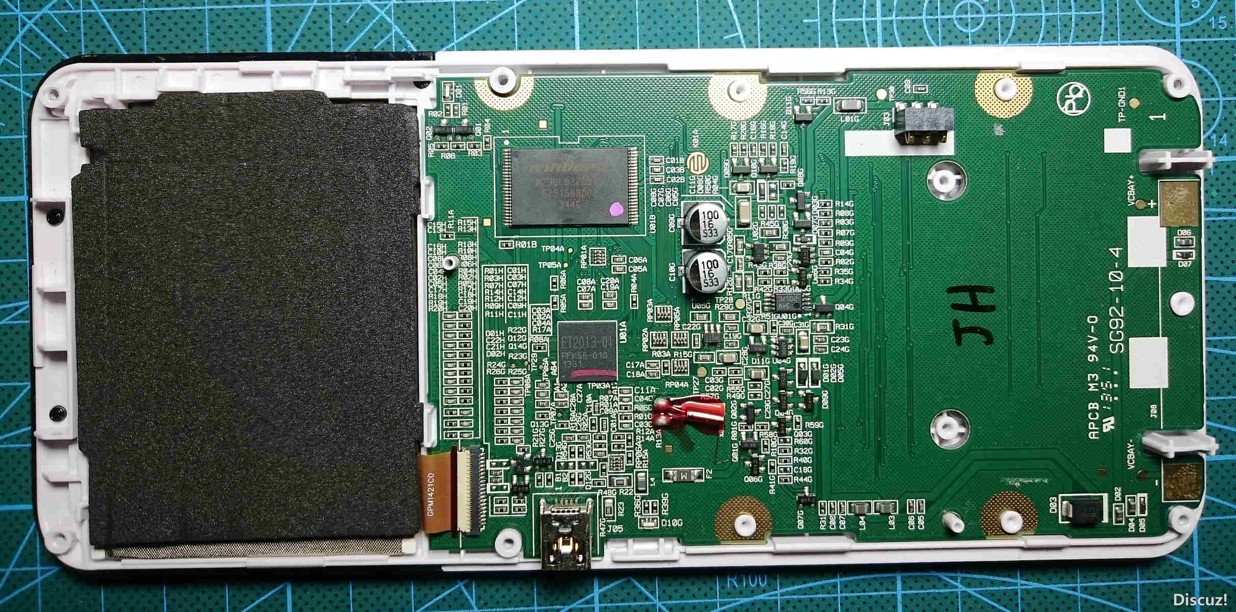

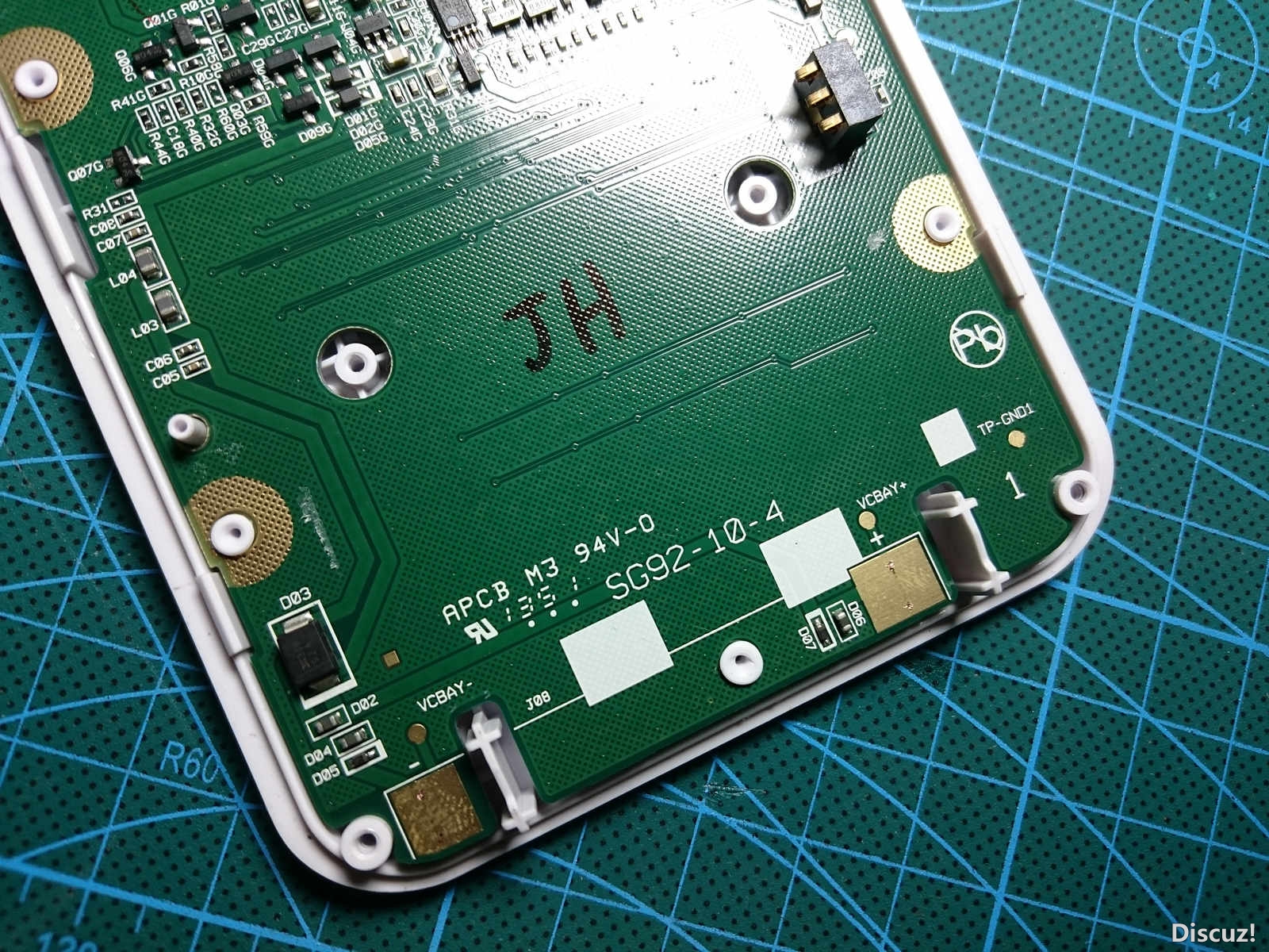

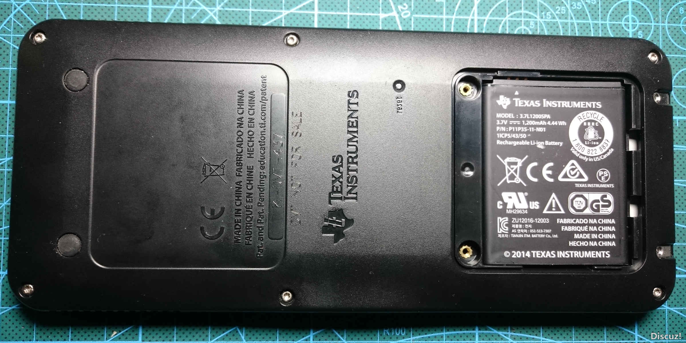

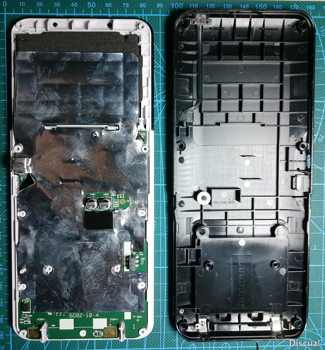

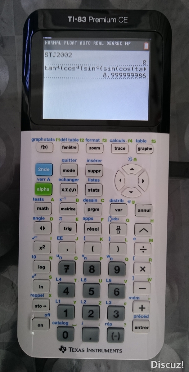

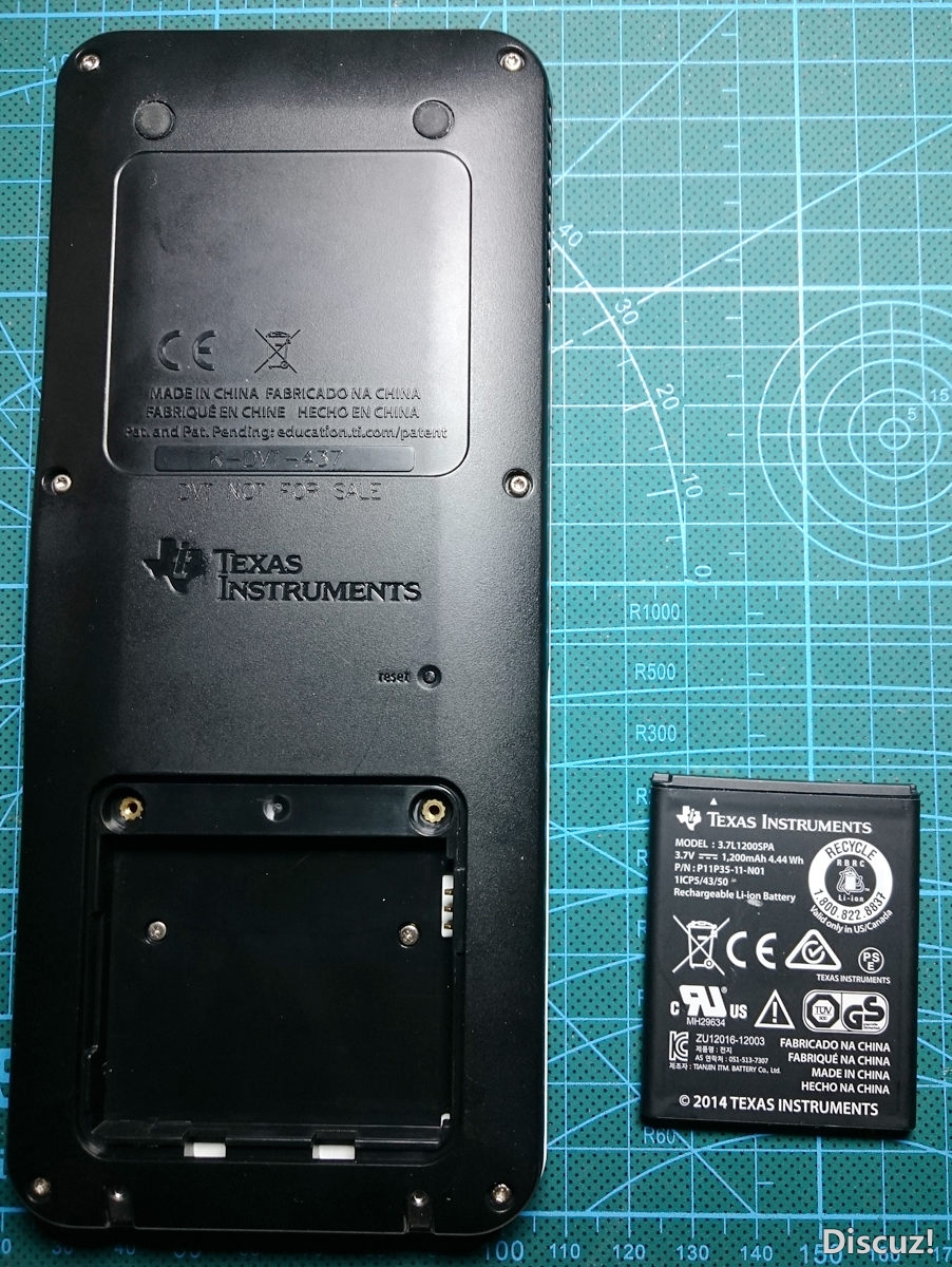

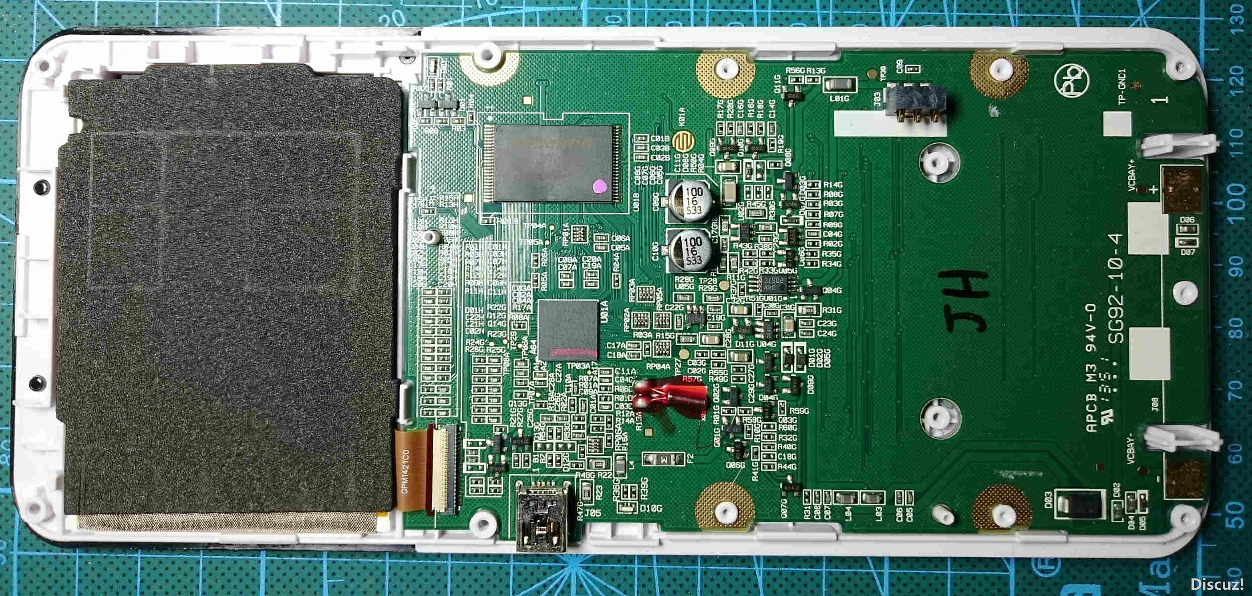

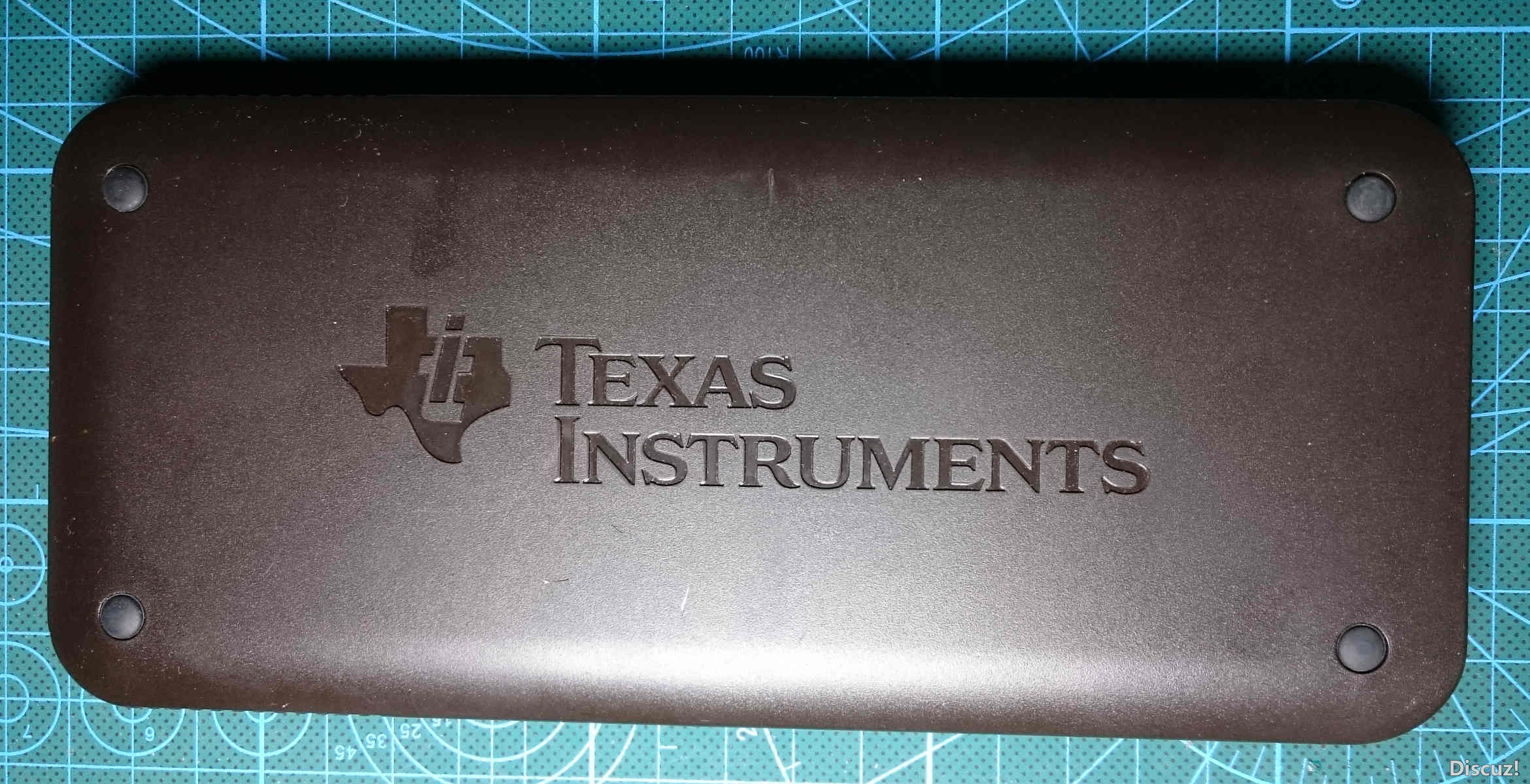

 楼主| 发表于 2017-6-10 22:32:25 | 显示全部楼层

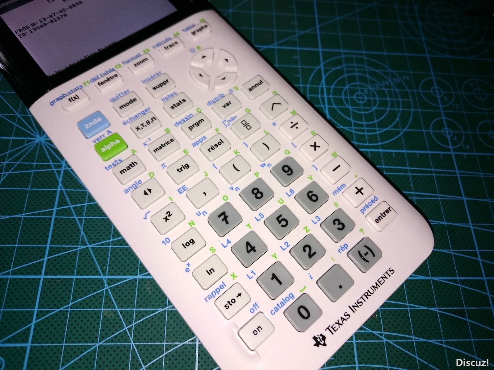

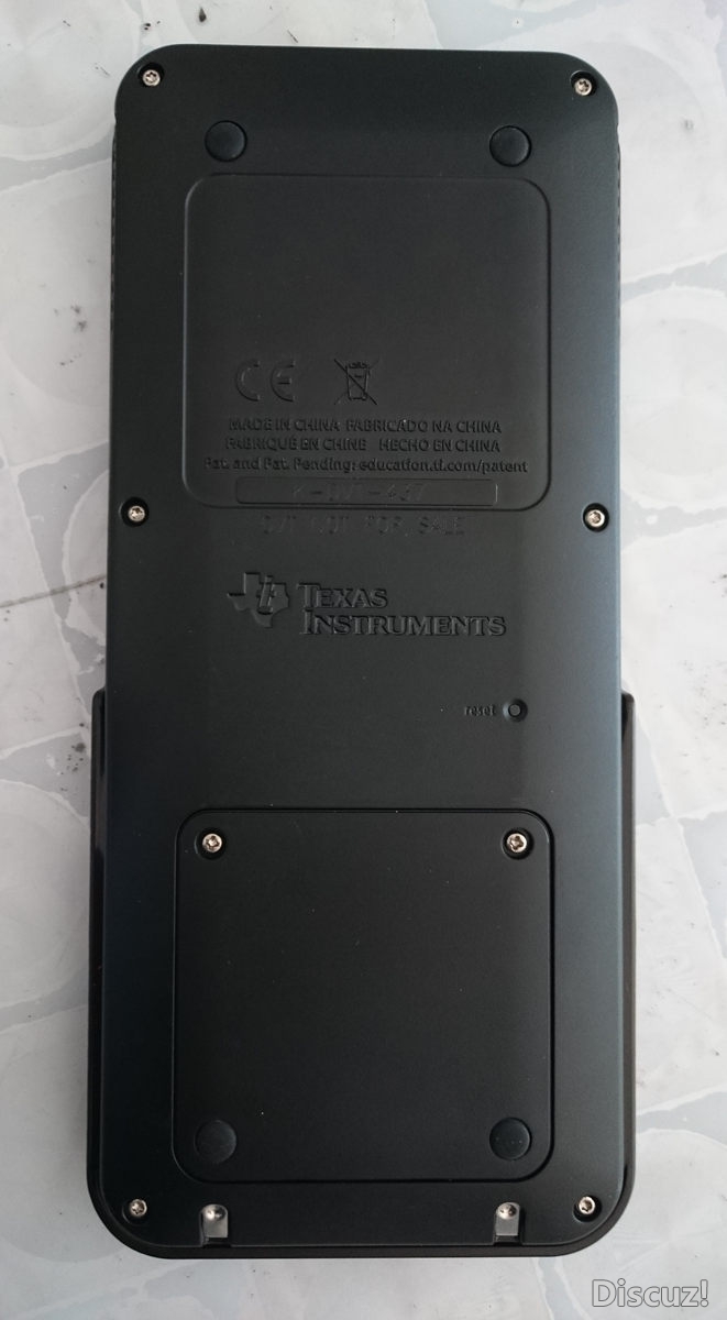

The photos about the appearance and disassemble of my TI-83 Premium CE prototype, before it turns brick:
Anyone can use these photos freely. Hope to be useful to the investigation.
By the way: If anyone has any idea about how to unbrick this calculator, please reply to this post. Thanks!
欢迎广大吃瓜群众前来围观。
Thank you for visiting this post.

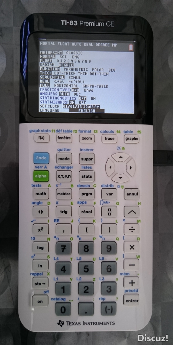

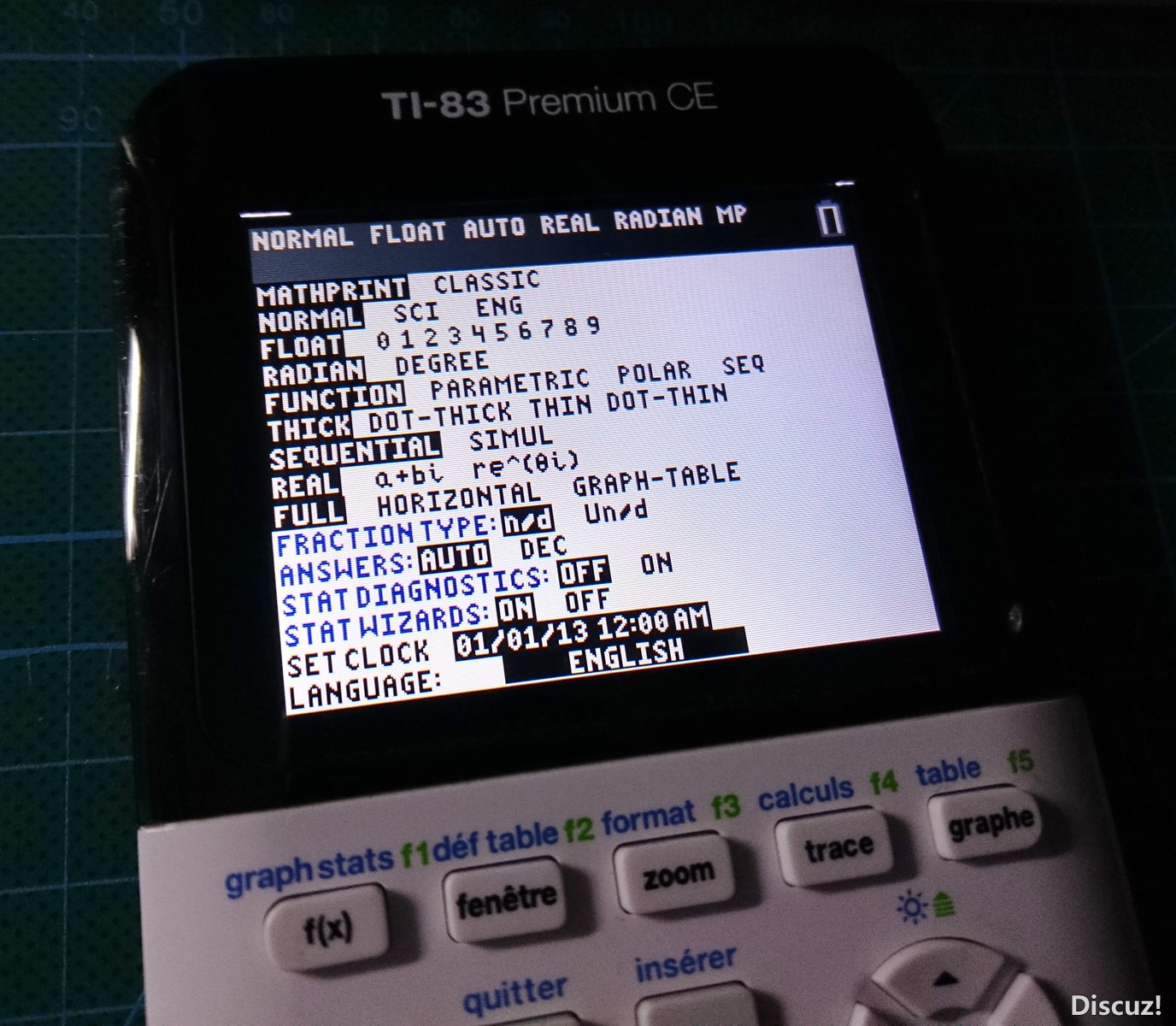

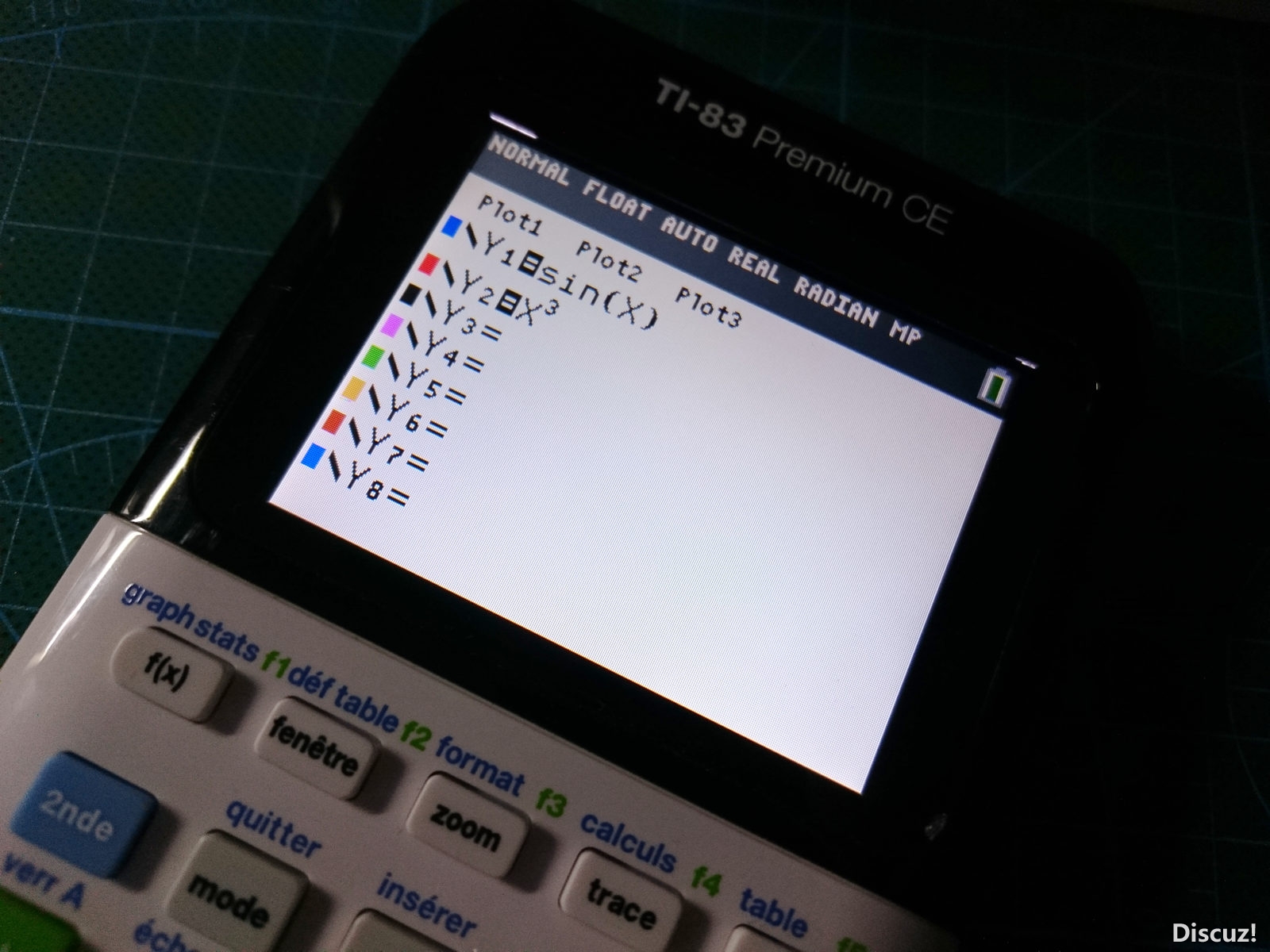

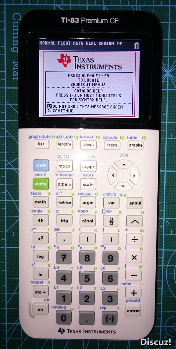

 楼主| 发表于 2017-8-4 18:15:13 | 显示全部楼层
think21st 发表于 2017-8-4 15:11
查了一下没有英文语言可选
有的。看17楼那些 TI-83 Premium CE 的照片,屏幕显示的都是英文界面。MODE 设置里语言栏中就有 English 可选。
