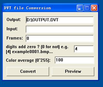

New converter released!Completely written in C. Save more memory and faster!
DvtCon.zip (41.79 KB, 下载次数: 73)
 楼主| 发表于 2012-6-9 22:26:25 | 显示全部楼层
How to use:

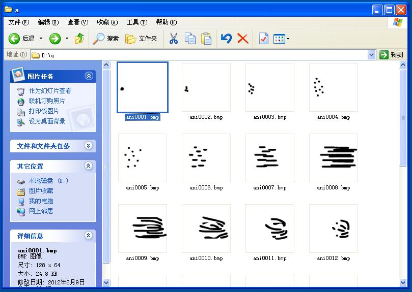

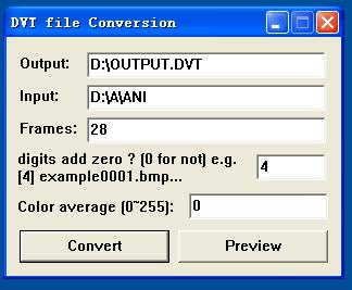

There are 28 pictures (must be 24-bit bitmap)
you can enter the following parameters:
COLOR AVERAGE threre must be 0,the The main colors in the picture is black (RGB (0,0,0)).(Gray value less than or equal to COLOR AVERAGE was considered as black)
Then you can click "Convert" to create dvt file
