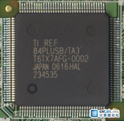

But the most important with a historical evolution, it's the ASIC, the chip that contains the processor and the RAM!
Nothing comes to mind ?
Let's clean its surface:
The ASIC chip is TI-REF 84PLUSB/TA3! :~o
We are talking about the 4x36 ping ASIC chip that equips the TI-84 Plus with HW rev. G and below, as explained in a previous news, and that featured 128KB of RAM!

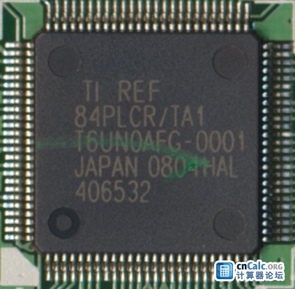

On the TI-84 Plus with HW rev. H and later, which is the majority of them right now and those on the 84 Pocket, TI used an ASIC called TI-84PLCR/TA1, smaller with  4x25 pins, but which only featured 48KB of RAM. :(
Even if it hasn't been tested yet, we can bet on having 128KB of RAM for the TI-84 Plus C Silver Edition, and a 15MHz z80 processor.
Having 128KB of RAM is a great news for resources-hungry apps developers (which will be even more with the color....)
The use of the same ASIC chip that on the old 84+ is probably a very good omen for the updates of actual TI-z80 emulators
Let's just hope that the supposed 15MHz will be enough to handle a display color depth of 8 or 16-bits, requiring 4 to 8 times more processing power on screen output operations.
But for the 128KB of RAM, a big thanks to TI which not only proved listening its users asking for it for years, but also by making, I think, an ambitious choice towards the future, opening the gates to a number of community programs and applications that will make this model a success !
