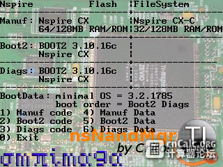

I've just updated nsNandMgr to 1.05.
http://tiplanet.org/forum/archives_voir.php?id=10080
The new version will:
- show you the Manuf RAM/ROM capacities
- in no case modify those capacities when you flash a Manuf image
So, in the specific case where you use nsNandMgr after modding your TI-Nspire CM into a TI-Nspire CX, reflashing the manuf in order to customize your boot screen won't brick the calculator anymore.
Note that the CX to CM mod is still forbidden in that version, and you'll have to use the version modified by nbzwt for now.
Transforming a CX into a CM just means bricking it, and that's why it was forbidden: your current OS will be removed and you won't be able to officially install any OS anymore.
Of course, you've got Nlaunch - but if you don't have the CX 3.1 Boot2, Nlaunch won't work... and if you have no RS232 adapter to flash it, it's a permanent brick :(
So be sure to follow exactly all steps of the CX to CM mod tutorial in the exact order they're being described.
It might be wiser to wait for Nlaunch CM which won't require you performing anything dangerous.
