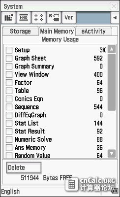

About the RAM, the RAM chip was also 2MB on the Casio Prizm, but only 64KB were available for the user. And here in a similar way, we've only got 512 KB available for the user! :(
