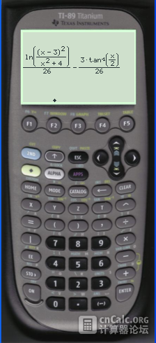

tigcc自带的example里的pretty print中的代码
  TRY
    push_END_TAG ();
    push_quantum (VAR_X_TAG);
    push_parse_text ("1/((x-3)(x^2+4))");
    push_quantum (INTEGRATE_TAG);
    NG_rationalESI (top_estack);
    WinClr (DeskTop);
    Print2DExpr (Parse2DExpr (top_estack, FALSE), DeskTop, 0, 50);
  ONERR
    DrawStr (20, 20, "Error!", A_NORMAL);
  ENDTRY
