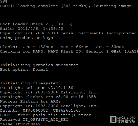

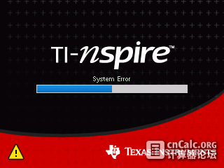

We could confirm that when updating a current TI-Nspire CX to the new 3.2.4 Boot2, it was still possible to reinstall the old Nlaunch compatible 3.1 Boot2.
But we hadn't tested this on new TI-Nspire CX coming preloaded with versions 3.2.4 of the system and the Boot2 ...
And although Boot2 3.1 is flashed successfuly through RS232 on these units, it is simply unable to run properly!  {:thumbdown:}
The boot2 fails on a non-recoverable error (System Error) and the RS232 console tells us a little more with the "BOOT2 Error: posix_file_init() error".
It's an error that has to do with the file system. But it's obviously still intact, as when flashing back the original 3.2.4 Boot2 the TI-Nspire CX boots successfuly.
So, Texas Instruments did probably change something on the new TI-Nspire CX, something that is managed properly by the new 3.2.4 Boot2 but not the old 3.1 Boot2.
Up to date, we do not know exactly what it is
So basically, Texas Instruments just invented us a new antidowngrade protection, "Boot2 antidowngrade protection". But managing to make its own older version of the code crash instead of giving you a clear and related error message is not very clean from my point of view - it just looks like a dirty hack - we were used to much cleaner protections so far...
